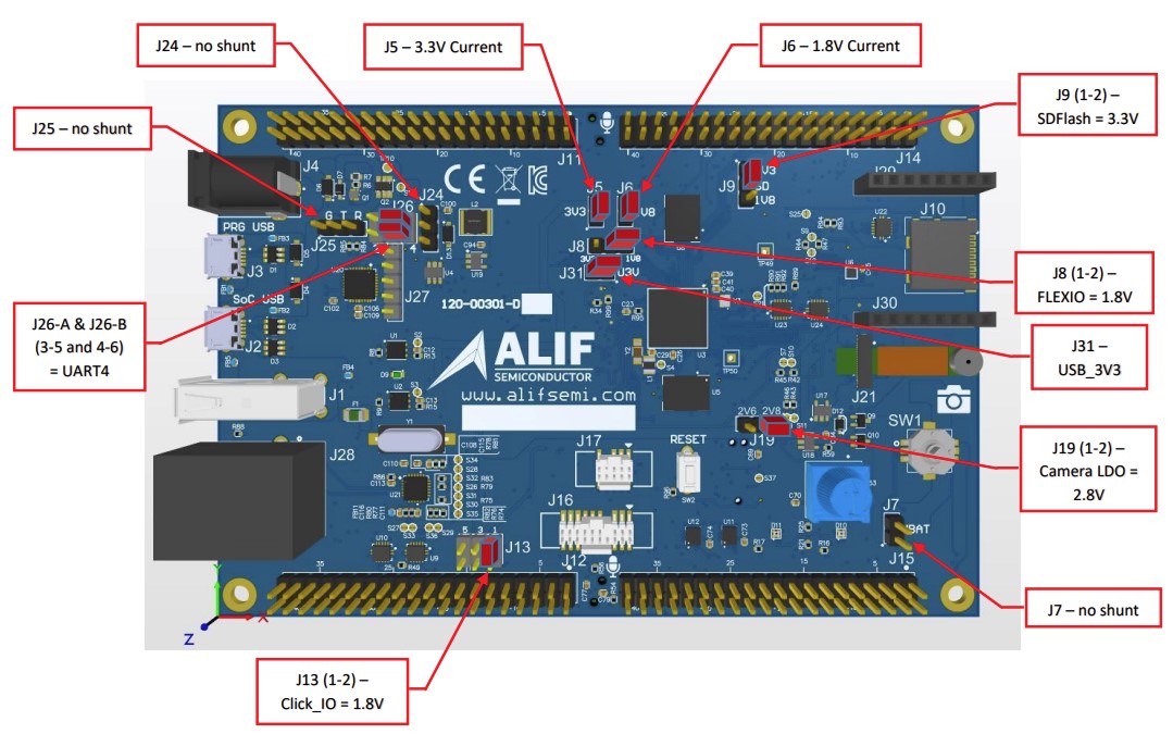

Overview of DK-E7 HW:D2
The following picture shows the default board configuration.
Board Top View

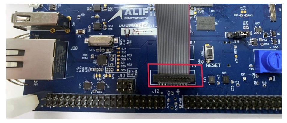

Connecting a JTAG Debugger
The board provides Cortex Debug connectors (J16 and J17) to connect an external JTAG Debug Probe. The picture below shows a Segger J-Link with 19-pin Cortex-M adapter connected to J16 on the DevKit.
Connecting a Debugger
