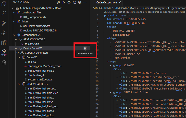

The VS Code Arm CMSIS Solution extension lets you run CubeMX from the CMSIS Solution View.
In the dialog Create New Solution choose a device or board and select a CubeMX template (which contains the
Device:CubeMX
component). -
Use
Run Generator
that is available for the componentDevice:CubeMX
in the CMSIS Solution View. This starts CubeMX and once the configuration is complete, click in CubeMX the buttonGENERATE CODE
. The generated code is imported with fileCubeMX.cgen.yml
as shown below.

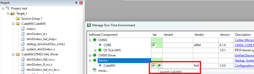

Usage in uVision
The uVision lets you run CubeMX from the Manage Run-Time Environment Window.
Select a device and enable in the Manage Run-Time Environment Window the components:
CMSIS:CORE
Device:CubeMX
Use
Launch CubeMX
in the Manage Run-Time Environment Window. This starts CubeMX and once the configuration is complete, click in CubeMX the buttonGENERATE CODE
