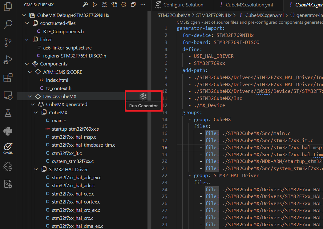

The VS Code Arm CMSIS Solution extension lets you run CubeMX from the CMSIS Solution View.
In the dialog Create New Solution choose a device or board and select a CubeMX template (which contains the
Device:CubeMXcomponent). -
Use
Run Generatorthat is available for the componentDevice:CubeMXin the CMSIS Solution View. This starts CubeMX and once the configuration is complete, click in CubeMX the buttonGENERATE CODE. The generated code is imported with fileCubeMX.cgen.ymlas shown below.
Note:
Refer to CMSIS-Toolbox - Configure STM32 Devices with CubeMX for usage information. It contains useful hints, for example for the configuration of an RTOS.

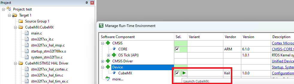

Usage in uVision
The uVision lets you run CubeMX from the Manage Run-Time Environment Window.
Select a device and enable in the Manage Run-Time Environment Window the components:
CMSIS:CORE -
Device:CubeMX -
Use
Launch CubeMXthat is available for the componentDevice:CubeMXin the Manage Run-Time Environment Window. This starts CubeMX and once the configuration is complete, click in CubeMX the buttonGENERATE CODE. The generated code is imported with fileCubeMX.cgen.yml.
