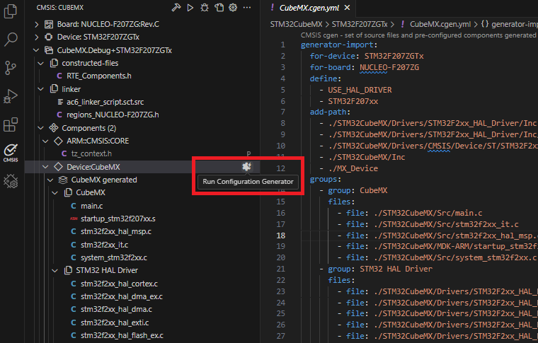

The VS Code Arm CMSIS Solution extension lets you run CubeMX from the CMSIS Solution View.
In the dialog Create New Solution choose a device or board and select a CubeMX template (which contains the
Device:CubeMX
component). -
Use
Run Generator
that is available for the componentDevice:CubeMX
in the CMSIS Solution View. This starts CubeMX and once the configuration is complete, click in CubeMX the buttonGENERATE CODE
. The generated code is imported with fileCubeMX.cgen.yml
as shown below.
Note:
Refer to CMSIS-Toolbox - Configure STM32 Devices with CubeMX for usage information. It contains useful hints, for example for the configuration of an RTOS.

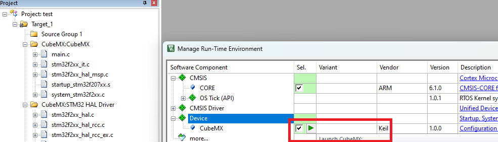

Usage in uVision
The uVision lets you run CubeMX from the Manage Run-Time Environment Window.
Select a device and enable in the Manage Run-Time Environment Window the components:
CMSIS:CORE
Device:CubeMX
Use
Launch CubeMX
in the Manage Run-Time Environment Window. This starts CubeMX and once the configuration is complete, click in CubeMX the buttonGENERATE CODE
