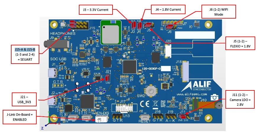

Overview of AK-E7-AIML HW:D3
The following picture shows the default board configuration.
On-board Debug Adapter
The board provides an on-board JLink debug-adapter with COM port routed to UART4. To enable the UART output configure the J15-A & J15-B to position U4.
